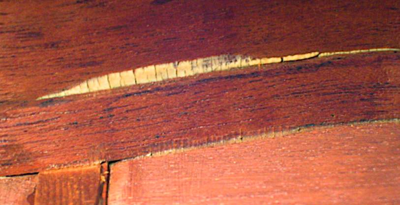

PostPosted: Mon Aug 20, 2007 2:23 pm
Posts: 2060
Here's a shot of a late '33 lining glue joint.
Before '33 (as best as I have been able to record) it would have been all hide
glue.

Great stuff! This is fun! Here are some specs,
body length=19 1/4
upper bout=10 3/8
waist=8 3/8
lower bout=14 7/8
Here are a couple more shots of braces and glue. The glue is mostly transparent, lightly yellow.
